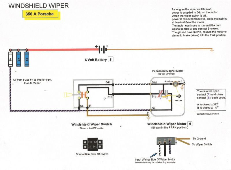

      Check the fuse first, then the wiring as above. And the motor will go over center in park and keep on running with out some mechanical load.
      wipers are pretty easy electricaly.
      The black and purple does not get voltage until you pull the switch. Then the motor runs using the black for one way, purple for reverse, push the switch in it provides the ground for park position.

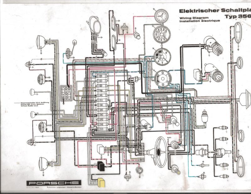

        This topic is still here, so I'll take the liberty to add more info via scans of other wiring diagrams to what Brooksie provided. He is likely correct in that less drag on the rotating wiper motor will either NOT allow it to "park" at a certain portion of the contact where it should (regardless of when the switch is turned "off,") OR it's a stuck part of the winding TRYING to find a better ground.
        The "boomerang" must come out (easier with the earlier than the later and easiest with a Roadster) to take the motor off the frame, BUT the cover of the motor may be removed easily to see what can be seen, tested, lubed, sprayed with contact cleaner, etc.

              Remove the fuse, Meter the back of the switch. "Pushed in" you could read continuity on the park ground brown wire 31b from the motor through the switch to ground via 54d. So take a meter and see which two contacts read continuity switch in. Once you have these two ID'ed. "Switch in" reads ground or zero ohms, "pull out" its open to ground. Brown wires on these pins. Reading from the wire side, one wire will read ground the other open.
              Then "push in" one of the un used plugs on the switch will read continuity back to the ground ( you are reading from the switch through the motor back to the switch pins 54d -31b is easy. This used black purple. The only pin left is the black wire 54 with power to the switch and motor, probably the pin with two wires in the back.
              Fold the wiper arms out so you don't scratch the windshield.
              Push switch in, install the fuse. Motor may bump then stop. Switch out wipers should work, push in they park.
