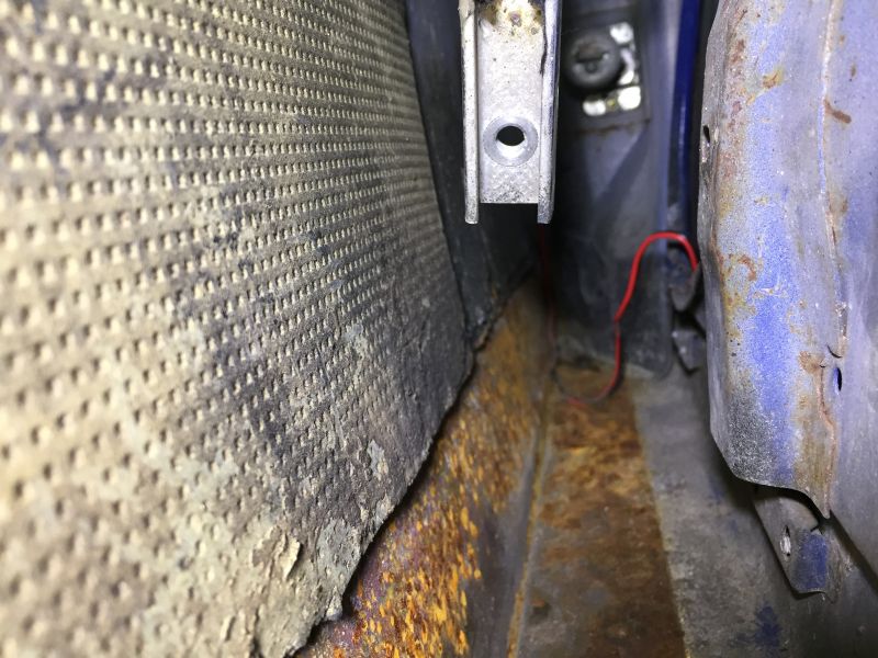

    I have my door apart right now. I will take a photo in the morning. If I remember correctly there is a bolt through the door shell, in the bottom that catches a bracket that slides into the window tract, about 4-6 inches up from the bottom.
      Perfect thanks , this is what mine has missing the connecting point. Does anyone have that part.
