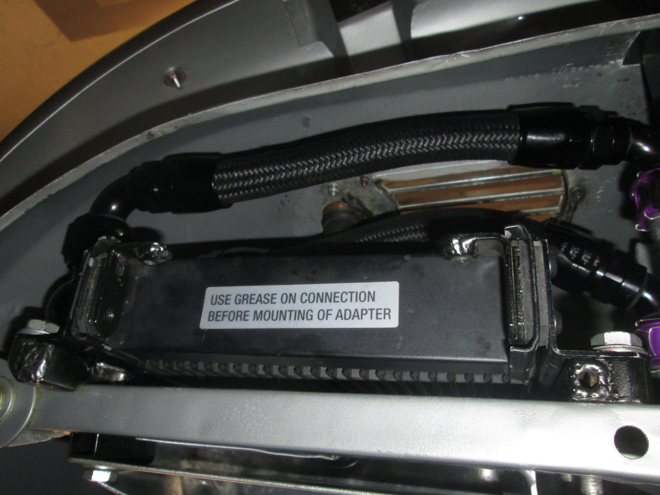

    Hey Pete, I'll ask Dean which tank they run back there but I would tend to think its the early 901 version. Do you know what year 911 the tank you're trying to use is from? As for a front oil cooler:

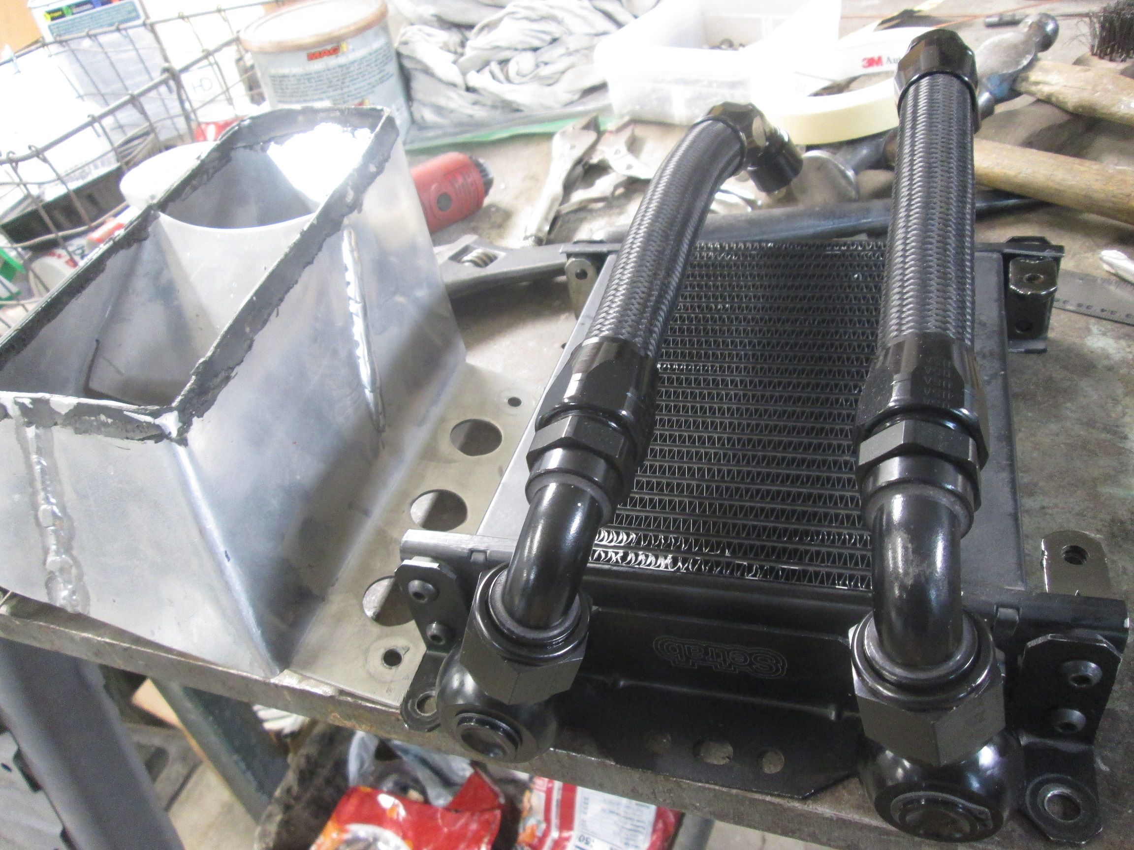

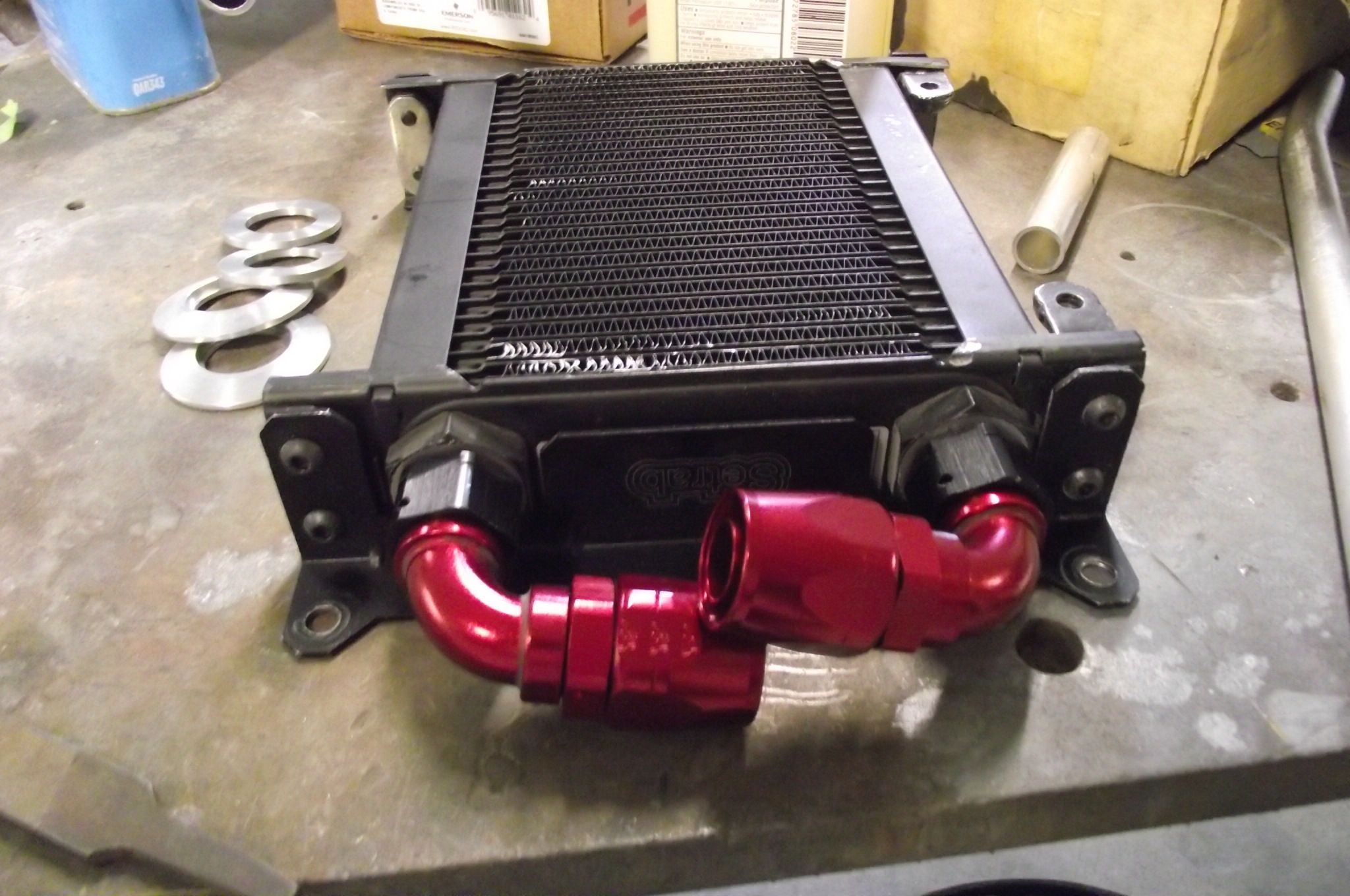

    Click image for larger version  Name:	carrera 753A.jpg Views:	0 Size:	300.0 KB ID:	112687 I'm running the smallest Setrab cooler that they offer. Click image for larger version  Name:	IMG_8377.jpg Views:	0 Size:	473.9 KB ID:	112688 The mount I built for it quickly unbolts without modification to the brace or bucket.

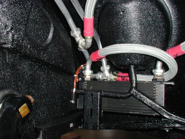

    Click image for larger version  Name:	mod356322.jpg Views:	0 Size:	87.9 KB ID:	112689
    This is the early twin cooler set up. The later setrab units are much more efficient than this early stuff so the one should perform the job of two.
    Click image for larger version  Name:	IMG_8577.jpg Views:	0 Size:	477.9 KB ID:	112690 No need for all of that complication above so I just went straight across the front. BTW: after I built all of this Dean said that the early 911 trombone tubular loop would have been enough to cool the oil. That would have been far easier and less complicated than mounting this cooler. Anyway, I'll see what oil tank they fit in there. Justin

      Click image for larger version  Name:	IMG_8567.jpg Views:	0 Size:	611.4 KB ID:	112719 The complicated plumbing example was a photo I found on the net. Mine is a simple straight over shot in front of the cooler now. The ducting to the left I built a few years before will have to be omitted but that's the way it goes as things change and develop.
